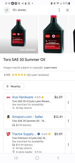

I'm looking for Castrol 30W oil and cannot find it anywhere, on-line or locally. I've checked AutoZone, Advance, O'Reilly, Walmart, Lowe's and Home Depot. So I decided to try for other brands, brands I recognize, not this cheap unknown stuff. The only straight 30W I can find is Super Tech but I have seen the independent wear test run on it and is ABSOLUTELY NOT as good as the nationally-recognized name brands.
I have been using this for over 4 years off & on. Now it is all I use in my Equipment that requires 30w oil. Haven't had any ring, valve or other issues. I do change oil regularly.I'm looking for Castrol 30W oil and cannot find it anywhere, on-line or locally. I've checked AutoZone, Advance, O'Reilly, Walmart, Lowe's and Home Depot. So I decided to try for other brands, brands I recognize, not this cheap unknown stuff. The only straight 30W I can find is Super Tech but I have seen the independent wear test run on it and is ABSOLUTELY NOT as good as the nationally-recognized name brands.
I see Castrol HD 30 Monograde Conventional Motor Oil at Walmart online. Its expensive though at $19 QT. Ebay has better prices for it though and free shipping.I'm looking for Castrol 30W oil and cannot find it anywhere, on-line or locally. I've checked AutoZone, Advance, O'Reilly, Walmart, Lowe's and Home Depot. So I decided to try for other brands, brands I recognize, not this cheap unknown stuff. The only straight 30W I can find is Super Tech but I have seen the independent wear test run on it and is ABSOLUTELY NOT as good as the nationally-recognized name brands.

Try Ace Hardware.I'm looking for Castrol 30W oil and cannot find it anywhere, on-line or locally. I've checked AutoZone, Advance, O'Reilly, Walmart, Lowe's and Home Depot. So I decided to try for other brands, brands I recognize, not this cheap unknown stuff. The only straight 30W I can find is Super Tech but I have seen the independent wear test run on it and is ABSOLUTELY NOT as good as the nationally-recognized name brands.
You probably won’t find it everything now it’s going to a synthetic blend no more conventionalI'm looking for Castrol 30W oil and cannot find it anywhere, on-line or locally. I've checked AutoZone, Advance, O'Reilly, Walmart, Lowe's and Home Depot. So I decided to try for other brands, brands I recognize, not this cheap unknown stuff. The only straight 30W I can find is Super Tech but I have seen the independent wear test run on it and is ABSOLUTELY NOT as good as the nationally-recognized name brands.
There are two Super Tech 30W oils at Walmart however, they are only sold in quarts as Walmart discontinued the 2.5-gallon jugs. There is a diesel variety but I don't mess with it. There is a plainly labeled SAE 30W Non Detergent lubricating oil which I don't buy. And there is the SAE 30 HD which I have been buying for years to run in a 2006 Snapper Rear Engine Rider with a 12.5 HP B&S flathead engine, and I never had any issues with the oil. I sold my Snapper this spring and bought a Toro Super Recycler with a Briggs engine and it runs very well with the Super Tech SAE 30 HD oil as the weather here is quite hot during the mowing season. Like you, I have searched for other brands of SAE 30 HD engine oil but Super Tech is all that I can find. Super Tech complies with the Society of Automotive Engineers (SAE) specifications for SAE 30W HD engine oil. Granted Super Tech is cheaper to buy, but it still must meet the same SAE specifications as Castrol SAE 30W HD or any other manufacturer. American Petroleum Institute lists the classifications of engine oils, https://www.api.org/products-and-se...d-classifications/oil-categories#tab-gasolineI'm looking for Castrol 30W oil and cannot find it anywhere, on-line or locally. I've checked AutoZone, Advance, O'Reilly, Walmart, Lowe's and Home Depot. So I decided to try for other brands, brands I recognize, not this cheap unknown stuff. The only straight 30W I can find is Super Tech but I have seen the independent wear test run on it and is ABSOLUTELY NOT as good as the nationally-recognized name brands.
