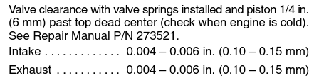

It's a Briggs and Stratton 407777 type number 0174-E1. Has overhead valves. Do you know the intake exhaust specs? are they set from TDC?
Work you way down the page. Click on the 3 links below.

Specifically
