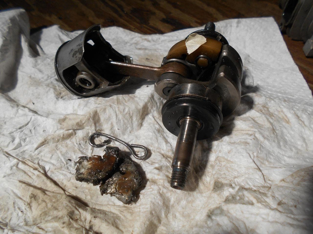

IE: An Echo CS355T Chain saw, "blown" (locked up) that I went into (out of curiosity) AND was able to repair.
A crankshaft "stuffer" failed (came apart) and locked up the engine. No internal damage to the engine, removed the other one and re-assembled. It's now back into service for my customer with NO NOTICABLE difference in performance. Saved a $350 machine from the scrap pile..
