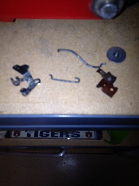

Today, i decided to take off the carbureator and fuel tank and clean out any grime. While doing that, it was extremly hot outside and i just disconnected all the throttle linkage without taking a picture. Now i deeply regret that and after putting the carb and fuel tank back on, im clueless. I don`t remember what cables go to what. Also, a copper wire comming out of the engine broke off a piece, i dont know what that belongs to. The model number is 802022288019102103 , any help would be GREATLY appericated.
these are also my left over parts- the last part (not washer) is the piece that came off of wire- also please exclude washer i just realized and the green wire on the carb= that was my error, the piece w/ the green wire and hole is my concoction.

The part with black on it, it looks like a throttle control lever. Keep in mind that when the throttle lever is moved to increase engine speed, a spring is tightened pulling on the carbs throttle. The engine's governor (probably in this case is an air vain next to the flywheel) will pull back with a direct control wire connection.
What anchored the throttle lever to the carb? Get that connected. You'll probably have to take it off again to get the control wires hooked up.
Pics are a bit blurry.
