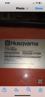

Neighbor replaced a blade spindle and now the belt wont stay on. Husqvarna riding mower/tractor. What do we need to look for ? Thanks

You need to post the model and serial numbers for your unit. We hate throwing out guesses as to how to help you with out knowing which of the hundreds of different models of Husqvarna tractors made. Which blade spindle did he replace?

Ok thanks ,I will get with him and get that information.
