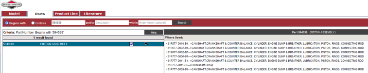

Standard piston. 594539 is a supersede for 796172.
796172 > 594539 Before date code 14100100
594435 After date code 14093000
Should have come with a cheat sheet but I see if Briggs is of any help it may take a few days. email sent to tech support.
