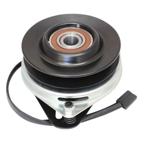

I'm baaack... The old clutch came off without any problem. It's an Ogura ma-gt-dx11cu. I see online prices from $300+ to $100+. Of course the lower prices are on Ebay. I've not had any problems (yet) ordering through Ebay, but ... If allowable on this forum, can anyone suggest a source somewhere between $300 and $100? I don't expect 17 years like the original, but more than one year would be good.

Have you looked on xtremeope.com?
They will run you around $200.
107
12,081
Try around $317
OX Clutch has it for $250
LSU-Mike
Jun 10, 2019
46
The Ox Clutch replacement is available on Ebay for $162.95 with free shipping. I guess I'll go for that one. Too bad it has to come all the way from Eugene, OR. My grass and weeds in south Louisiana won't wait so I'll put the old one back on in the meantime.
