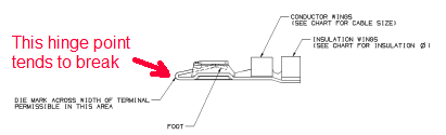

Can't clearly enough to see what I like checking. Is the terminals spring hinges in tack or are they cracked or flatten?
I light thru at least a couple of them and I am not talking about the empty slots.

Not referring to the plastic housing but the terminals themselves.
When this happens the terminal to mating terminal becomes loose and can lose contact at the root; hence, lost of electrical conductivity. Sometime the connections arc and burn the contact points.
And you must each and every terminal that is associated with the PTO wiring and also check the switch itself as they do burn the contacts internally especially when you have a partially short PTO clutch field winding. PTO clutches normally on pull 3-7 amp with 7 amp max being the max. Most PTO are only rated for 5 amps. PTO field resistance should be above 1.7 ohms.
