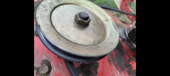

Bottom one for the blades came off fine (probably 90 ft lbs to loosen) - but how are y'all holding the spindle shaft or pulley to loosen that top spindle nut?

Actually you should remove the pulley nut first and then the blade. This way you can block the blade to help removing the nuts/screws.

Use an impact and you can hold it easily with a rag or gloves
Sprayed some PB Blaster on it - used some heat on the nut.... more PB Blaster...
Impact & rag/gloves just spun in my hands. I used a pair of vice-grips to hold the pulley (figure I'll replace the pulley if I destroy it trying to remove that nut) and that nut wouldn't budge. Put my 6' breaker bar onto it - and it just laughs at me.
I think a 1200lb gorilla must have tightened those nuts onto the shafts.
I'll try that. See my other reply I just made for some entertainment value. lol
