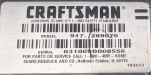

I will be checking forest's suggestion start a new thread but I am including one more image. I mean the only thing I could think of for new thread is I've had the mower deck away from the riding mower at least a dozen times + I guess the thread will be starting from scratch even though that's not true. Couple things I did notice the last time I slid the mower deck underneath the frame somehow the whole mower deck ended up closer to the rear tires so I had to adjust that rod that attaches to the front of the mower deck never did that before.
I replaced the large pulley I noticed a large pulley has some wobble in it so I tighten it as tight as I could and I removed the wobble and now the wobble is back I don't know if the wobble is supposed to be there.
This belt is only maybe a month old I'm sure if I buy another belt it only takes a few times for it to get all screwed up.
And the reason I believe besides the obvious belt problem but there's something wrong is when you engage the blades there's this constant ringing noise and I can't figure out what is coming from I'm assuming it's the mower deck because that's the only time it appears but who knows.
And when I engage the blades and I have that constant ringing noise I think I'm going to blow another head gasket on the machine it just seems like that's going to be the next thing to happen and then I go back to the engine and replace the head gasket.
In the photo you might notice a very strange belt angle and that's because the mower deck is right on the ground normally it's pretty much horizontal.
Jim
