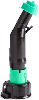

That is why I used to preach about getting a new style EPA nozzle for your can. Those new spring loaded pain in the buttocks nozzles help keep the trash and water out.
