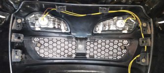

Wiring and light bulbs remade

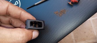

Problem switch

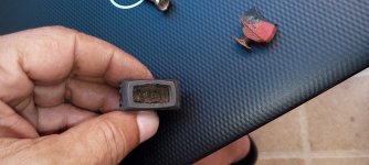

Clean switch

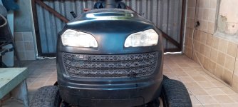

Headlight off

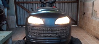

Headlifht on
