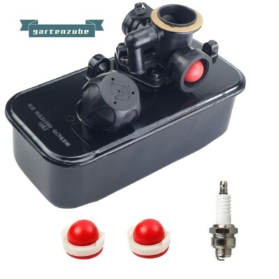

I’m wanting to replace the carburetor & fuel tank with one of these from ebay and not sure if they will be the right part, could someone tell me if these are universal or engine specific?
This is my first step in repairing this as I think the coil may need replacing also.
From looking at the B&S site for my engine it looks as if part# 393113 is the fuel tank # and 394591 is the carburetor #
Ebay & Amazon have a few combos that I’m looking at if someone can tell me if they will fit.
Hutdkte 494406 Fuel Tank and Carburetor for 499809 498809A 96900, 98900, 9B900 thru 9H999 Series Engines with 698369 27987S Air Filter Kit
https://a.co/d/04nl61mM
Both tanks look the same but the part# are different, if I done my research right it looks that part # 396781 superseded part # 394591
I like the Amazon kit because it includes the springs that I need it just doesn’t have the same part#
I’m guessing both of these are the same but I don’t know.
This information was from a mower repair site: even though it’s say’s simplicity I would think it have the same part # it would be the same. I’m
(Superseded to 495912)
Thank you
