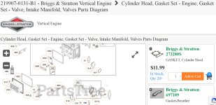

thanks on carb part# what is correct part# for head gasket?
The Brain
Jun 26, 2019
8
76
yeah thats what I came up w/ from parts tree. could a faulty carburater flooding the cylinder create to big of an explosion which ruined the head gasket?
