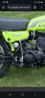

"All single cylinder motorcycles over 250 have a compression release"
My kawasaki 350 Bighorn didn't have a compression release.
