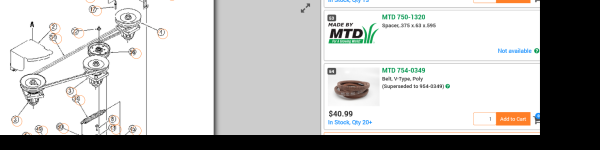

Broke the deck belt which was already badly worn. Book calls for 954-0349 but that is way too long at 79". I took some string and wrapped it around the pulleys ant it was closer to 60". This deck has 2 belts to run the blades, Top belt from the motor, around the tensioner pulleys and the left most spindle. The other belt ties all 3 spindles together. Now I don't know what length belt to buy or how to look it up.

  • / New to me 13ag601h729 in good condition but neglected.
the 0349 belt goes around the pulleys, looking at the diagram, it appears 754-04064 goes from the engine pulley to the double pulley on the deck. It measures at 68" though
Thanks for the reply but 68" still seems to be a bit long. The old belt is closer to 63" and unless it was routed wrong (doubt since the routing is pretty straight forward) the 68" would never engage. There are no visible numbers on the old belt. Makes me wonder if something was swapped out somewhere along its life. Trying to make sure I get the correct belt before purchasing.
I think the 63" is the way to go and I ordered one. Should be here in a couple of days. Thanks for all your help.
