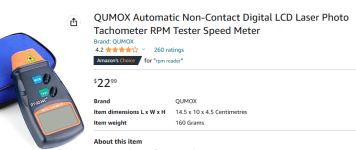

thanks for all the advise. So, will something like this work for me then? And if it will, is it a case that I aim it at the spark plug?
Jul 14, 2019
81
5,879
Get the cheap one like I did at 11 bucks to your door. You don't need NASA tools for mowers. I wouldn't get that kind anyway. Mine simply wraps around the plug wire.
