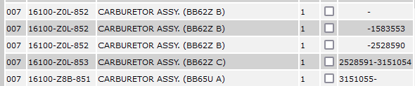

I would go by the engine's serial number and the chart I posted. Now it may have been superseded but I would not know until I plugin the PN of the IPL indicated carburetor.
The 16100-Z0L-852 was superseded to 16100-Z0L-853 and the 16100-Z8B-851 is a current PN. Neither supersedes to the 16100-Z0L-862.

When I looked at the ad, I realized that wasn't the correct model number. My engine is a GCV160 LAO S3A S/N GJARA 3112113.
Where did you get the chart you posted?
