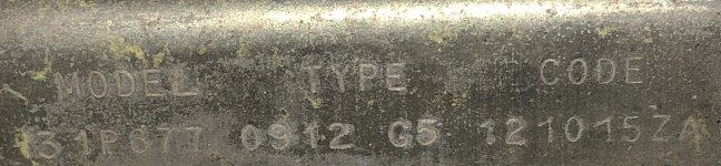

Here is the picture of the model number 78251CBA-D304-4188-81D0-211C42C4F710.jpeg
VTX1300
Apr 21, 2023
10
Here is the picture of the model number View attachment 63988
Recheck Engine Numbers nothing showing, click above & enter for Manual & Parts List.
thanks VTX1300, Mark
No problem, I’ve looked at everything I can find and I can’t find a diagram with that part in it, I believe it’s the original fuel pump

31P677.
Not the fuel pump.
