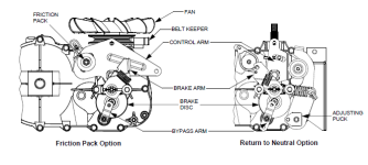

Okay does it looks like this?
Image 1
or this one
Image 2
Here a couple images of where these goes.
