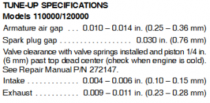

I would do simple things first.
Try a new spark plug, gapped to .030", if that doesn't do it,
Then i would check your valve clearances, being an Over head valve engine, it's simple. Intake valve should be .004-.006 and Exhaust is .009 to .011, Thousandths of an inch. (Not both the same, as the video stated)
This video is just to show you how to do it, I never worry about finding "top dead center" or 1/4" past it... i use the OVOOVC method, One Valve Open,One Valve Closed, set the clearance on the valve that is closed (the rocker arm will be loose)
Now if you find the valve are within spec, (i like to feel a slight drag on the feeler gauge,when pulling, no need to worry with adjusting them, of course.
