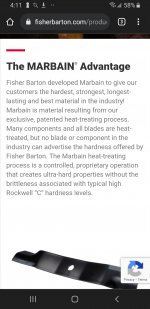

Look for Marbain blades. They are OEM on lots of commercial mowers. They are not soft.Screenshot_20211019-161111_Chrome.jpg

Look for Marbain blades. They are OEM on lots of commercial mowers. They are not soft.View attachment 58739
Thanks for reminding me about Rockwell hardness. I am aware of it but until now have applied that knowledge only to bolts, locks and chain. Maybe that'll help me get better blades.
