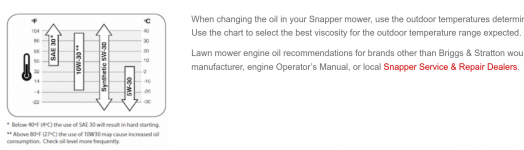

Noticed a while back. These viscosity charts are strange. Some charts say for example SAE30 is only good for 35C or 95F. Just like the Kawasaki chart you posted. Others say SAE30 is good to 104F ambient. Only a handful of degrees I guess. Here's a couple examples. Don't know what it proves?? Guess follow your engine manual on oil specs.
Jul 14, 2019
80
5,855
As you see the above charts are from different sources. Two mower related are from Briggs and Snapper. They don't even agree. Again only a couple degrees. Guess I will keep using SAE30, never lost an engine yet on it.
