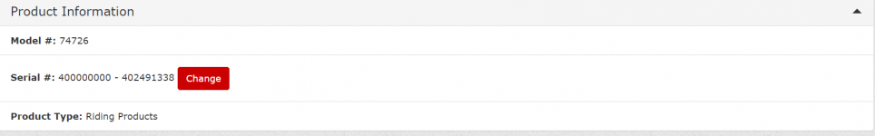

That is why we need to the actual model and serial.
74706 came with a Kawasaki FR600V
74721 came with a Kohler 7000
74722 came with a Kawasaki FR600V
74726 came with a 2P77F
74726TA came with a 2P77F
So there is no way to sure until we had the actual model and serial numbers.

S/N 402271470. I have the 22.5 hp Toro(Loncin)engine. I put the starter on the bench it appears that the motor doesn't spool up fast enough to overcome the spring on the drive, compressing the spring manually the drive will engage so I will be headed to the Toro dealer for new starter. I had luck in the past taking apart B/S starters clean up and work good but not this Chinese one...
