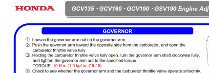

Hi,
My neighbor is having an issue with her push mower: https://www.lowes.com/pd/Troy-Bilt-...led-Gas-Lawn-Mower-with-Honda-Engine/50328177 the engine idle speed is too high. I still think it might be something fairly easy to fix, I'm just trying to get some feedback about the issue. I know running the engine @ higher than normal rpm is bad on the engine.
Thanks,
David
