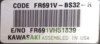

I cannot seem to locate a pdf engine parts manual to download. FR691V BS32-R. It does not even seem to exist on the Kawasaki site. Search says no such number.
But that is exactly what the tag on the motor says it is? I am trying to determine the actual carb number as well. It says on the carb Walbro 26B but on their site there is no such number either.

I also am unable to locate that engine. Can you do two things for us. Take a picture of the ID tag on the engine and the ID tag on the Hustler.

I have not been able to find any information on the engine with the tag number you posted. Looking at other Kawasaki FR691 engines I have to agree that the carb number he posted MAY be the carb for your engine. Before I would make any purchases for that engine I would contact Kawasaki at this customer service number. Kawasaki Customer Relations at 1-866-802-9381. Sorry I can’t give you a more definitive answer.
