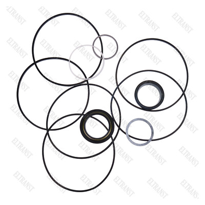

Parker TE wheel motor. Seals leaking for one thing but bushings (maybe needle bearings, just depend where in the SM they claim they are) are probably worn too. Not enduser rebuildable due bushing having to be pressed out and in but the seals can be replaced PN SK000090 Standard seal kit.
If attempt this I would recommend having the service manual for the wheel motor at hand.
