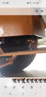

I have a scag tiger cat 2 and when the blades are engaged spark ar coming from this pulley any advise. I k ly have about 70 hours on tractor. Thanks for your help. I have attached a picture of the sparks location. This is below the engine.

Electric clutch is shorting out. Replace the clutch assy.
