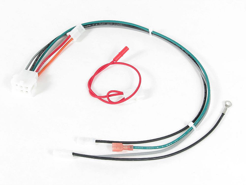

According JD the E110 has the 33R877-0027-G1 and the harness your looking at is PN 698329. Note the wire colors maybe different than the original harness.
PD_0071_500_698329

I searched for PN698329 on several web sites including John Deere and not there. Any idea where I can find this?
