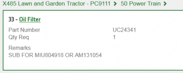

StarTech Lawn Royalty Top Poster Of Month Joined Feb 19, 2020 Threads 80 Messages 10,354 Jul 14, 2021 / IS there an oil filter for the rear axle #2
M MParr Lawn Addict Joined Jul 2, 2021 Threads 6 Messages 1,456 Jul 14, 2021 / IS there an oil filter for the rear axle #3 @StarTech gave you the part number. To locate the filter, look under the tractor at the front centerline of the axle.

O overdriv Member Joined May 15, 2019 Threads 8 Messages 13 Jul 19, 2021 / IS there an oil filter for the rear axle #6 Found it, yes on deck removal. Thanks.
