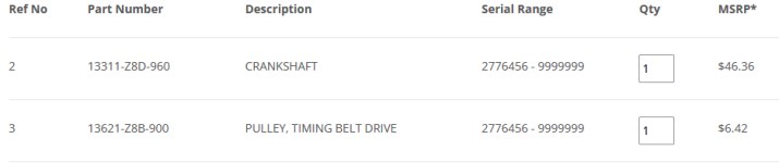

Hi,
So my wife tried to cut through a 2” metal pipe with our Honda HRX 217 mower, resulting in a bent crankshaft. I’ve got the crankshaft part number down to 2 options, 06131-Z8D-W50 or 13311-Z8D-960, but can’t figure out which it is or if there’s a difference. Attached is a pic of the serial number. Any help would be appreciated. Thanks

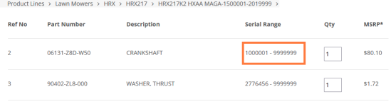

New crankshaft part number I came up with is 06131-Z8D-W50, but to tell you the truth I’m not sure it is correct. If I had this unit in the shop I would contact Honda. This site has the info. https://engines.honda.com/company/contact-us
Guategate
Aug 23, 2023
Ok, thanks! Yea, 06131-Z8D-W50 is what I’ve been coming up with too. Appreciate the help.
