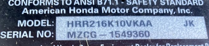

HRR216
This is reason we got get the equipment actual numbers. Something currently just don't add up as I have yet anything like it either used. The OPsaid it been a shop 3X andyou know as well I do even good shops hires funkies to do the work.
HRR216K10VKAA
