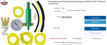

Get a 2 way tester like the Mighty Max and get the all metal one
Otherwise you are going to end up with a drawer full of tools that only do 1/2 the job and will spend more time switching between tools that fixing the machine.
Joe Pace has a short series on You Tube that takes you through the BEST LOGICAL sequence of testing machines fitted with cube carbs.
There is an order that really needs to be followed
You start with the tank and test in both pressure & vacuum
The tank that the Lawn Girl showed is faulty and the machine will start fine then die after a few minutes or when turned on its side .
After finding Joe Pace's videos I virtually stopped pulling carbs apart because substantially fewer were actually faulty, but I have replaced a lot of bad fuel caps and fuel lines that are leaking where they pass through the tank.
So while I have lost out financially by not being able to charge the customers $ 14 for a $ 1 gasket & diaphragm kit I have won with the fixed $ 45 service fee and now turn them around in a few minutes rather than a few hours or even days because I ripped into the carb, then it still has problems , so ripped it down again, boiled it n the ultrasound for an hours, dried & rebuilt it for the 4th time reassembled the tool only to find it still did not work properly .
A big problem with chain sws because a lot of them take a very long time to get the carbs out in the first place .
