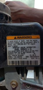

I have a Sears Craftsman 6.75 horsepower lawn mower. Tecumseh engine. Can't find the Tecumseh engine number anywhere but I have some information from the Craftsman label. I have been told I need a new carburetor or a carburetor rebuild. It seems I can get a new carburetor off of Amazon much cheaper than doing the carb rebuild.
But I can't seem to get 100% certainty on whether the replacement carb is the correct one.
Model 143.056700
DOM (? Don't know what that is) 05073CD0767
195cc
Amazon description:
640350 carburetor for Tecumseh V195EA LV195XA LEV100 LEV105 LEV120 6.75 HP engines.
I can't find those numbers on the mower anywhere. Where should i look? How can i be sure this matches my mower.
Thanks so much

Thx. When i read the reviews of the carbs they seemed to be happy with them. The shop near me wanted $140 to rebuild. I wasn't sure what was involved and while i can likely do the mmechanics of the work, i didn't know if i would be able to make the judgment calls on what looked good or bad to replace or adjust or work on. Suggestions of where to get the parts you mention?

I should mention... i didn't actually post that carb number. That was the amazon description of a carb for sale there. I doubt it is tecumseh. They likely just used that carb number. Still not sure that is the part number of what i have currently.

Thanks for all the work you went through in typing it out. I've got to admit that is more than I think I wanted to take on. That's partially why I thought just replacing the carburetor would be the easier way to go. But I'm still left with the question as to how to verify that what is being advertised on Amazon, matches with what is currently on my lawn mower.

Appreciated. I guess what I'm trying to ask though is how do I verify the part number that is currently on my lawn mower? Not whether I can trust what is posted in the Amazon ad, but how I verify what is currently on my existing lawn mower. The sears label doesn't seem to have real specific info as to the tecumseh engine model? Or does it?

Doesn’t take a lot to verify the engine. Just type in the number, that’s what i did to justify my reply. I dont know any other way to prove it to you. https://www.partstree.com/models/143-056700-craftsman-engine-made-by-tecumseh/
When you say "the number" it seems you are referring to the number on the amazon ad. I don't know where on my lawnmower or what number from the sears label, is the one to use/match since the sears label seems to refer to the craftsman model but not the tecumseh engine model.
