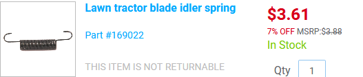

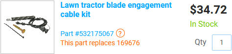

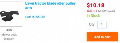

917.274822 mower engagement parts / Any or all of these following parts do freeze up regularly . Storing outside and lack of cleaning the deck will accelerate the problem.
Replace cable if not working. Craftsman 917 model numbers are manufactured by American Yard Products.
Sears parts is one of the most expensive places to buy parts.
