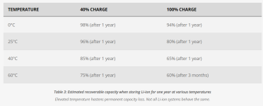

I recommend storing the battery indoors to get the longest lifespan possible, (lithium batteries do not like heat) I also store the battery at 75% charge which will retain the maximum longevity of the battery, refer to the following article to understand why:

I am careful to store the battery indoors and leave it at 50% charge to get the longest possible lifespan out of the battery, I only charge it the night before I plan to mow:

There is no information provided about the root causes for the fires which forced the recall, but I am going to choose to continue using the battery based on my previous experience with observing LiPo fires due to abuse around racing radio controlled cars. Essentially, heat is the #1 cause to premature battery failure, so storing a lithium battery in a hot garage is a very bad idea as heat tends to increase voltage so keeping a battery on a full charge will compound the risk with heat which tends to cause the cells to swell up. Once there is any visible signs of the plastic case swelling then it's time to discard the battery. Almost every LiPo fire I've seen at the race track was confirmed by the owner who knew they had a very old battery that was swollen and needed to be replaced but they kept using it anyway. Another prime time when fires occur tend to be when the battery is being charged. Not all batteries have the ability to balance their cells and the cell closest to the true negative tends to get worked the hardest and not having the ability to measure the internal resistance of these cells increase the risk over time. More info here:
