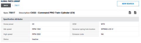

Anyone have experience using the aftermarket kits and could make recommendations? I have a 2000 Command 22HP twin that I bought that has been sitting a long while. model:CV22S spec 75517 serial number begins with 33 (which I think means its a year 2000 engine).

First your spec comes back as a CV23 (22hp) and the serial number is a 10 digit then the year is 2003.
And those OEM kits are ridiculously priced. I don't see any after market kits out there either. The best price I found was the following.

Ah yeah, I meant starts with 30. The one I'm replacing is a 33. Weird that 75515 comes back as a CV23... Kohler tag attached. Yes those OEM kits are crazy expensive, so much so I'm tempted to just try it as-is.

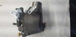

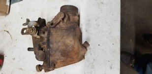

I rebuild quite a few old tractor carbs and the good carb kits are usually around $100
Before and after or one i did recently
