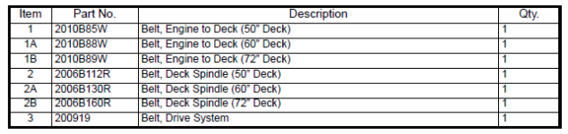

I am trying to replace the belt from the engine pulley to the blades, it is 88” by 5/8”. It is on a 2020 3160kw. I took the tensioner pulley off. But I cannot get the belt around these big azz pulleys! What is the trick? I have tried spinning it on and using screw drivers to pry it on, but there is no give in the belt. Am I going to have to take one of the pulleys off?

The closest model I can pull up an IPL for is a 2018 model. Can you link us to the IPL showing the 88" belt as the one I got is a lot longer belt. But you may a double belt setup.
And yes many times on mower decks the idler pulleys have to be loosen up to get the belts pass the belt retainers.

so I got the 88’’ belt on and it is very snug with no room for the tension pulley to go back on. In my manual it lists an 89” belt for a 70” deck. Is there any chance my mower could have the same size pulleys as a 70” and require a 89” belt? Would DC do such a thing? there is no way to get the idler back on with this 88” belt.

That the problem you have the wrong belt. DC #2010B88W is a B (5/8") x 91" cloth wrapped belt.
And 70" deck is DC 2010B89W which is a 92" belt.

Ok so I may have called it the wrong thing. It is the Engine to deck belt.

Yes that is what it is called ( or can be the Primary deck belt) and that is what I figured out here. And even the deck numbers I previously post are wrong as I was looking at the wrong machine which has one deck belt system.
In the case of the 60" deck its secondary belt is B x 133" Raw Edge.
