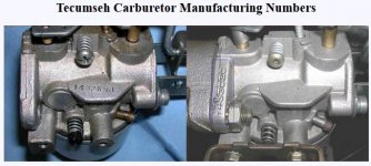

I would need the number stamp into carburetor and not the casting number.
Tecumseh carburetors will have a manufacturing number stamped on the mounting flange or the body followed by a date code. The mfg. no. on recent models is four digits (early can 2-3 numbers) and is followed by three characters for year, month and day of manufacture.

  • / Beginner Question - Correctly Identifying the Carburetor 512
Following your advice, I found the number 1548 followed by what looked like LAF, but the middle character is really faint, so that is just a guess. Using the resource, I see that a 1548 is a 632795A. When I look on Amazon, I see that those are available for $14.29 with free shipping and good reviews. More encouraging is the ads specify this is for 5HP lawnmower engine. And, as a bonus, the reviews stated that many start and run problems were fixed by installing the carburetor.
