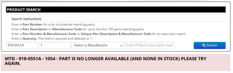

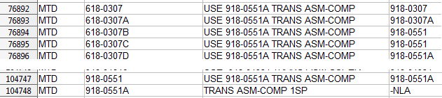

First you don't have the 618-0307C but instead have the 918-0551A which NLA. You must find an used good unit.

Ahh that number was superseded by MTD before they obsoleted it.
Here is the supersede list from my recent price download.
