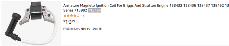

Have a near new (very low hours) 1997 Vanguard 7.5 in a Ryan Lawnaire 28 aerator.
Starts early on first pull. Dies when hot.
Replaced all fuel lines, fuel line cutoff valve, new Briggs and Stratton carb, new spark plug, changed oil, new Briggs pre filter and air filter. Think it’s the ignition coil but can’t fine a new one other than the cheap eBay types…
Any one have any ideas or sources for a Briggs coil? 715982 is the part number of the coil. All the places listing it as available don’t have it in stock and Briggs is sold out. Thanks
76
10,225
Might try getting an aftermarket one through Amazon. USA price and delivery time out of China.

Thanks for pointing that out. Really want to avoid non Briggs parts if possible. I searched on the forum and it was mentioned about sanding the coil and it being a problem on the Vanguard engines? Has anyone had any experience with the grounding issue and sanding to clear the warm engine cutoff issue?
