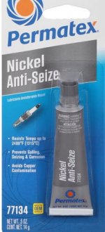

When I did mine, the bolts which hold the spindles all came free. Thus, I just replaced the bearings. Don't go with cheapest Chicom; spend a bit more for Timken, SKF, MRC. It is common for the bolts to be corroded in place and twist off in the spindle mounting flange. When this happens, it's easier to replace the complete spindle assembly.

Anti-sieze is your friend.
