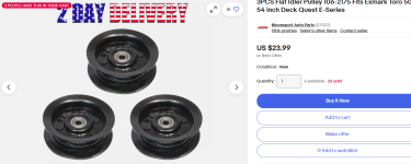

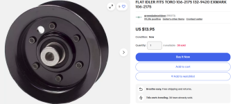

And for us that willing to use eBay you can the same pulley today prices for $14 including shipping. And you both of the idlers it is $13 ea.
This provided they are the 132-9420 which lists for $32.99 not $65

For true; depending upon how one writes the search, using that Toro part number, I found prices from one only for $15 to $29.95 each.
And to be clear, the $65 for two pulleys was from the local small engine shop. Time and place utility has a cost.
Interestingly, the photos used in most of the listings currently do not show the rivets. Are today's pulleys spot-welded together?
