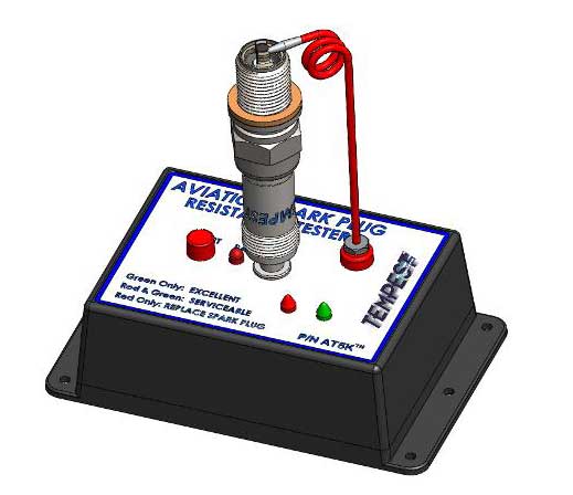

Be nice to have consensus on acceptable 20K test values for Resistor plugs and non-resistor plugs?
Best to test hot or cold?
Cold 20K test results for new:
Non-resistor BS 491055T plug = 4.88. Continuity - no. External ground – no.
Non-resistor BS 694385 plug = 8.01 Continuity -no. External ground -no.
Resistor OILE K6RTC plugs (3 tested) = 0.0. Continuity – yes. External ground -no.
Comments, test values welcome.
