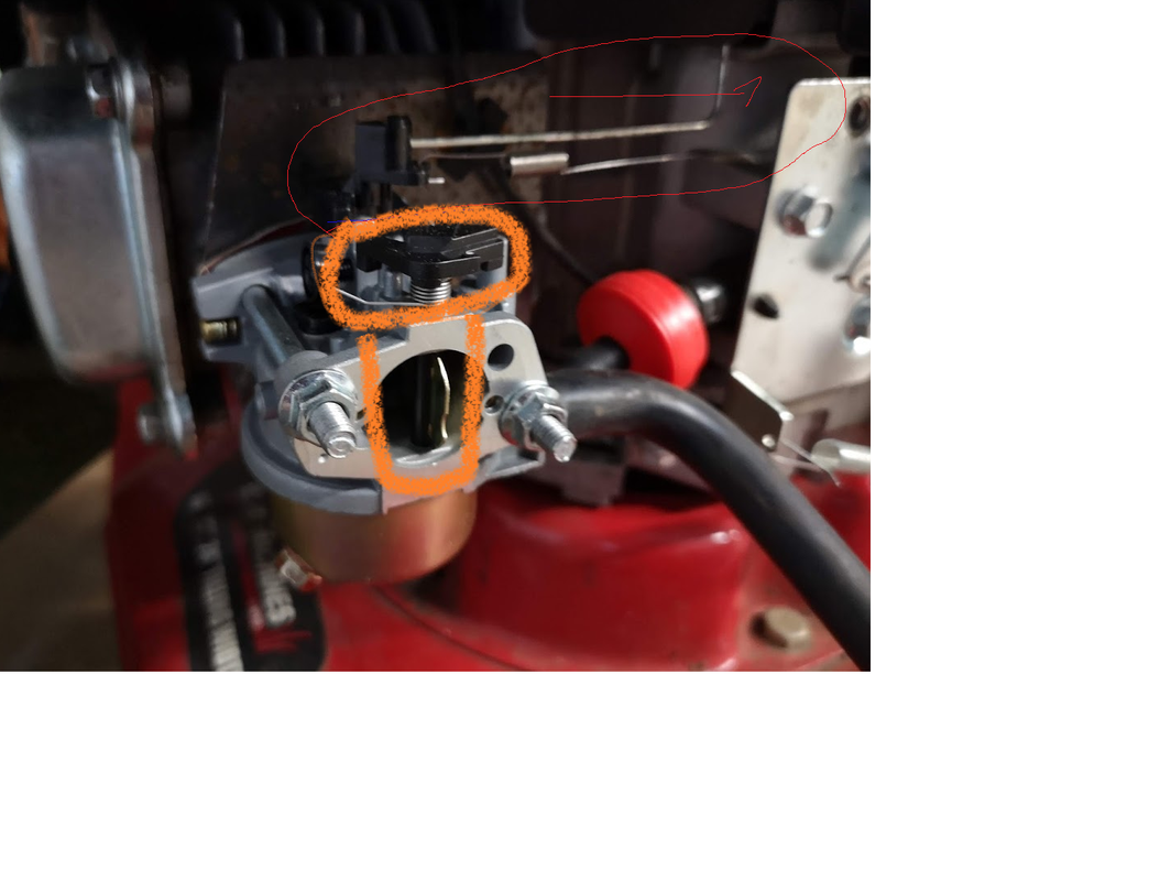

Hi, I have a mtd tiller that I am trying to get started. I last ran it a few years ago. I bought a new carb, correct model number, fuel filter, hose, gaskets, etc and it still will not run. I am using a drill to start it and it fires up if I press the governor arm all the way over. Springs and everything look fine. Once it is running it has no power and dies when I engage the tines while in the air. I don't see too many adjustments and am at a loss as to what could be the issue. Maybe the gaskets are in the wrong order, but I've tried arranging them differently. I also bypassed the filter and tank to make sure it wasn't a fuel delivery issue.
