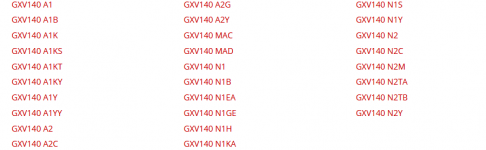

Thanks for that info. Do these photos identify model number?
110
12,249
That would be type number MAJ.
