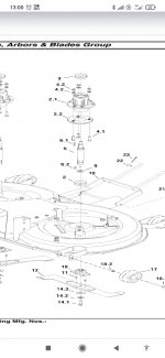

I have a simplicity regent xlrd 22hp with a 42" deck. I purchased it in 2008 and the deck is now rusted through. I have taken it all apart except for the spindles (shafts). The rust is holding it tight and I don't want to damage the thread at both ends. I have used lots of WD40 to free it up but to no avail. Any ideas of how best to take it apart would be appreciated. Diagram and pics attached.

However from the IPL I would get a short socket headed cap screw to replace the blade bolt
Flip the housing over and lay into the cap screw
