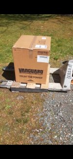

The first engine arrived in an original factory box. It had a large white sticker w/ the engine S/N and barcode from the factory. It had "Trust the Power" with "Vanguard" in large font underneath and I think an image of the engine. I'll post a picture of the box/packing when the second engine shows up.

I forgot that I took a few pictures of the engine and box as proof of condition before the driver took it. I've attached them. The engine is secured in the box at the bottom with a thick piece of cardboard with a cutout for the crankcase to fit in. The top has a similar piece of cardboard that fits snugly over the gas tank.

I believe what you posted, but don’t believe what you were told. Many years ago, before I retired, I had the opportunity to tour a Briggs and Stratton manufacturing facility and can tell you that NOT all engines are tested before shipping. Saw engines go directly from the manufacturing line into boxes. There evidence you posted of scratches show that the engine was rotated in a dry condition. The packaging you posted does look like manufacturing line packaging. There are many ways to read warranty statements and yes once INSTALLED you need to go through Briggs warranty claims. I still stand behind My statement, look for another supplier, but understand your reasoning to stick with them at this time. Good Luck in your venture.
