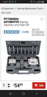

Never had any luck using a 3 jaw puller on sheet metal pulleys without bending them. I have used a bearing separator with an air hammer to get pulleys like that off.

Thanks everyone. I tried a pulley puller and it started to bend the pulley so I stopped. If I used heat and the puller, I feel like the pulley would bend alot easier. What the difference between a bearing and pulley puller?

Bearing puller will apply force at the thick part of the pully near the shaft and will not damage the outer edges of the pully
