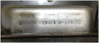

I've about a 15-year old Craftsman lawn tractor (917.275760) with a 18.5 hp OHV Intek engine (engine model 31p777-0299-e1) that only runs on choke when hot.
